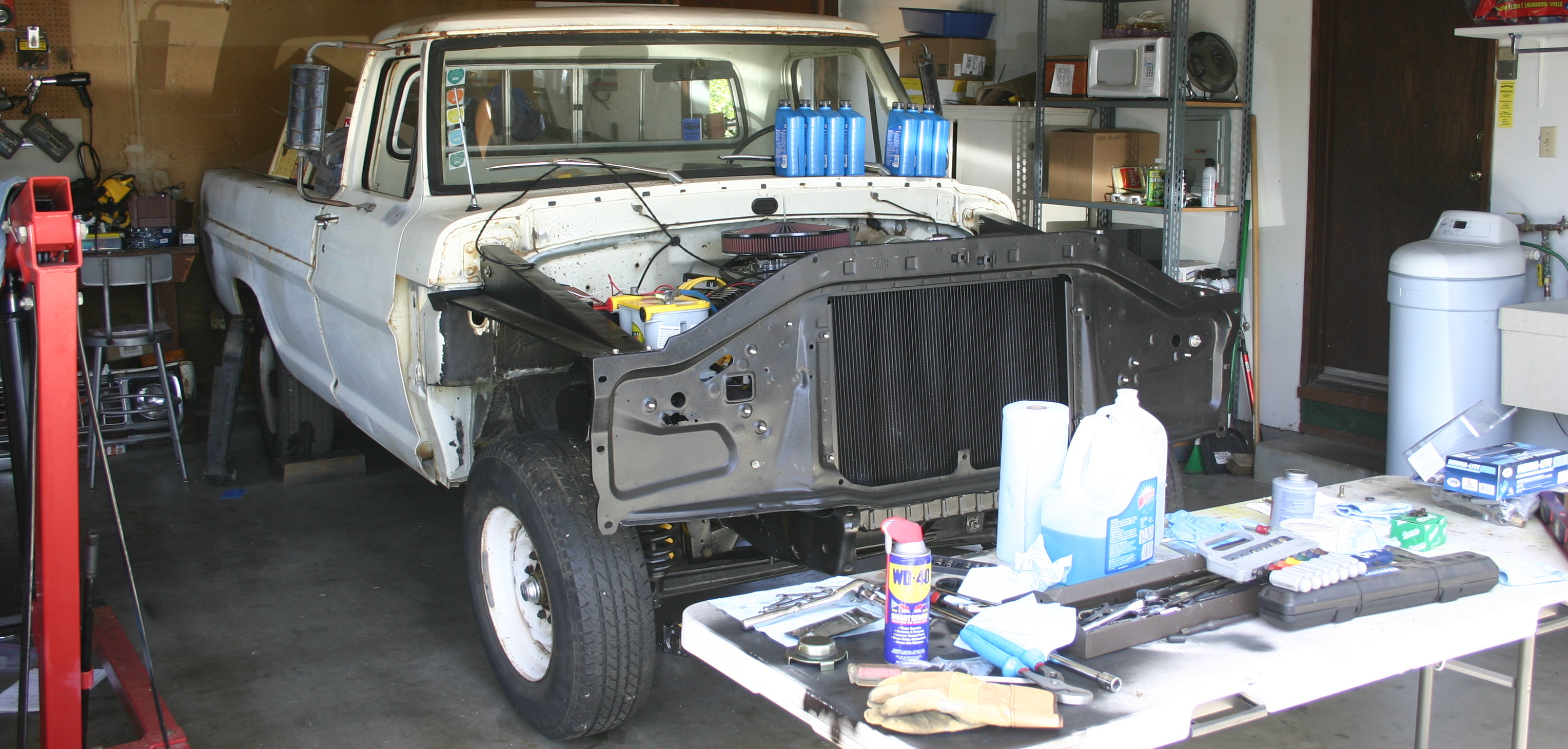

Hey Robroy, are you still running the inner fender mounted solenoid?
And...what's in the "Robs Baby Stuff" box next to the microwave?

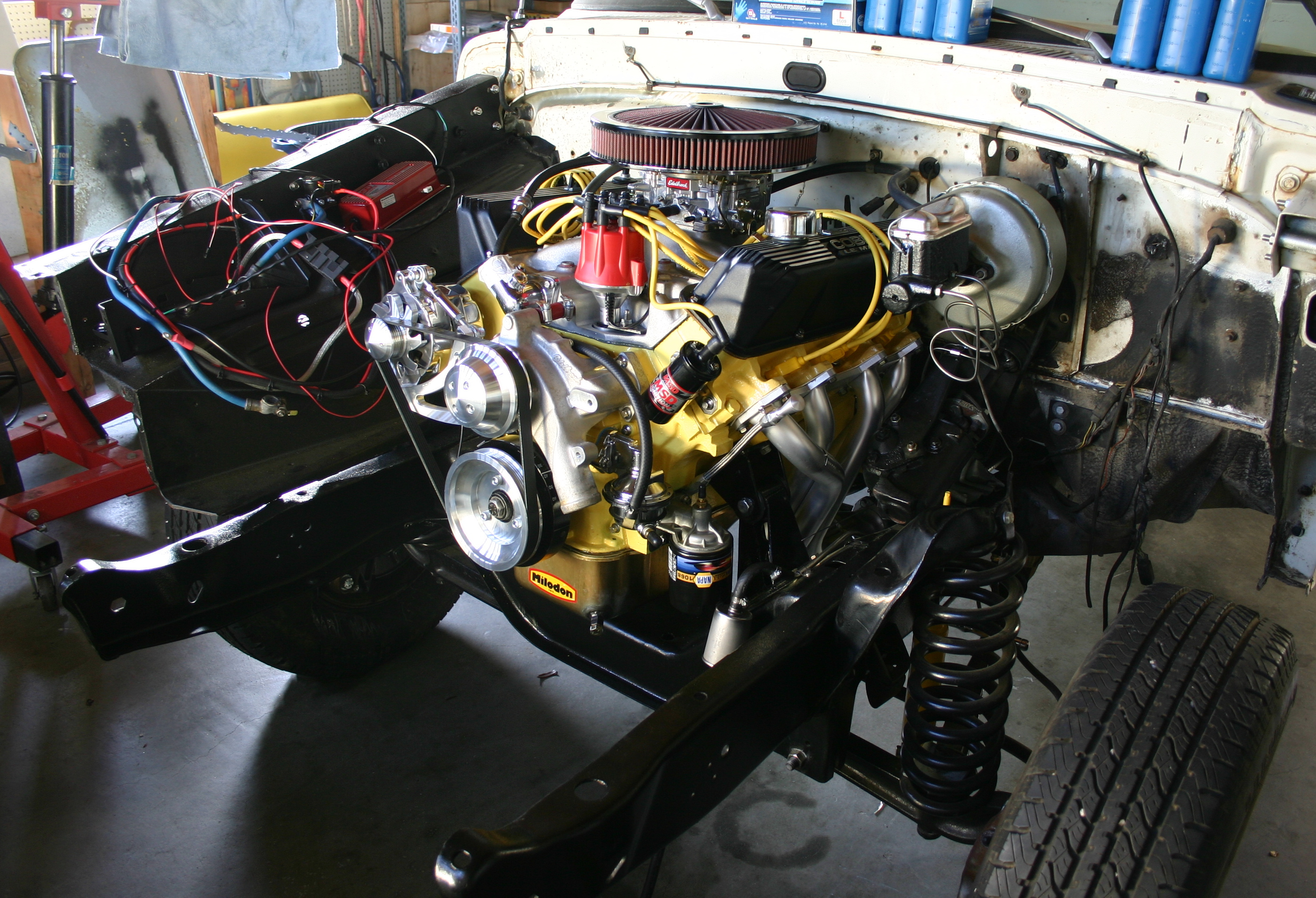

Here's #50's current state! Last night I installed the carburetor and partially installed an inner fender. It's coming right along!

Yes I am! The RobbMc instructions call for its retention, but it's wired differently. Instead of handling the full current to the starter as it normally does, it's re-wired to trigger the RobbMc starter's built-in solenoid instead. Thus, the RobbMc starter attaches both directly to the battery (in essence) with a large wire, and to the switched side of the inner fender solenoid with a skinny wire.BobbyFord wrote:Hey Robroy, are you still running the inner fender mounted solenoid?
Great question! And I'll have you know that my standards for humor and entertainment demand nothing less than a sincere answer: The contents of the box labeled, "Rob's Baby Stuff."BobbyFord wrote:And...what's in the "Robs Baby Stuff" box next to the microwave?

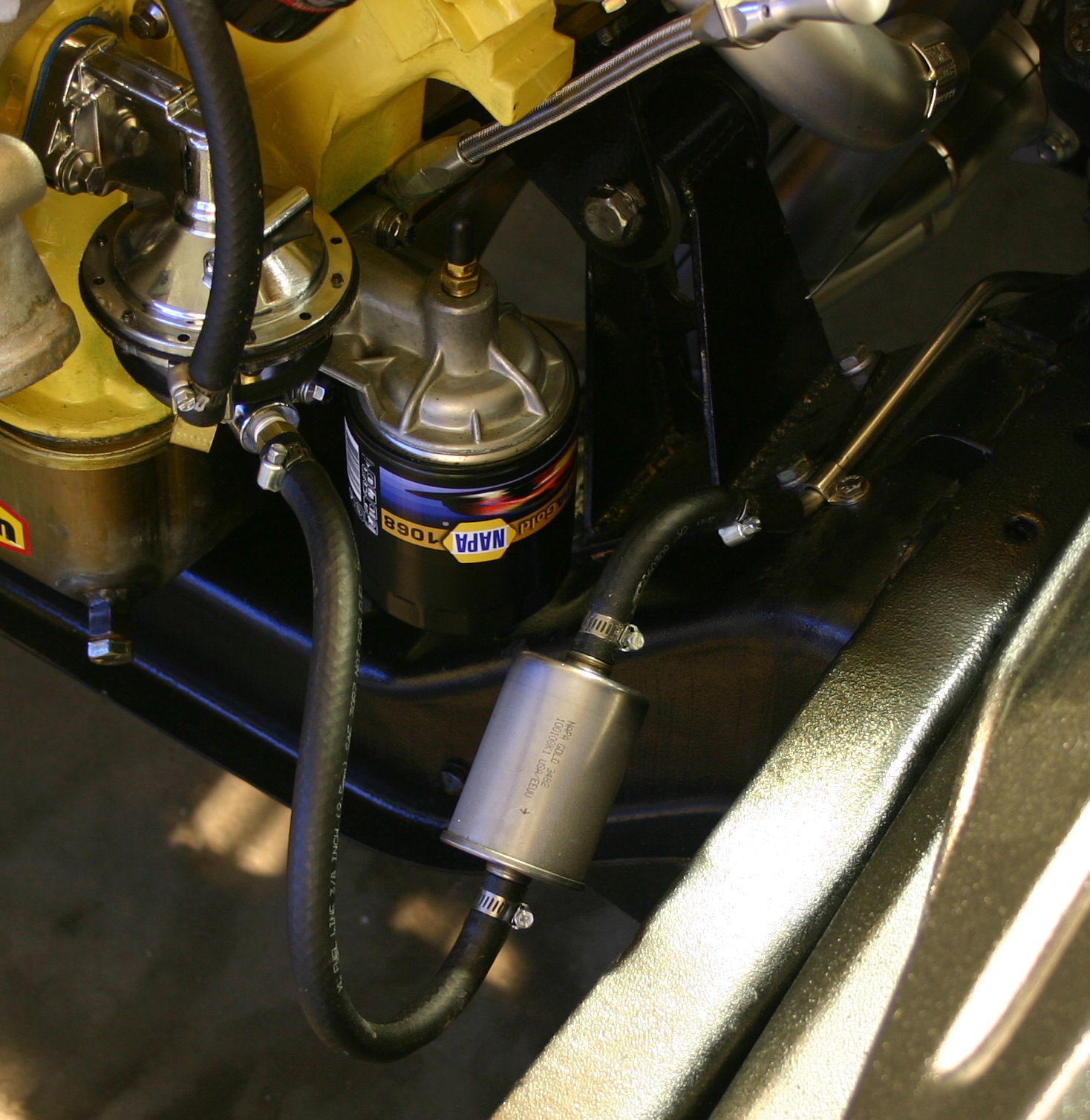

I've heard from both Jamie and Tom Lucas that it's best to put fuel filters on the output side of the pump. With this in mind, I'll run it with the filter where it is for at least a few tanks of gas, just to make sure any residual particles left over from all the new tubing, hose, and re-sealing the gas tank are caught. Once that's complete, I'll either remove it completely or move it to the output side of the pump!

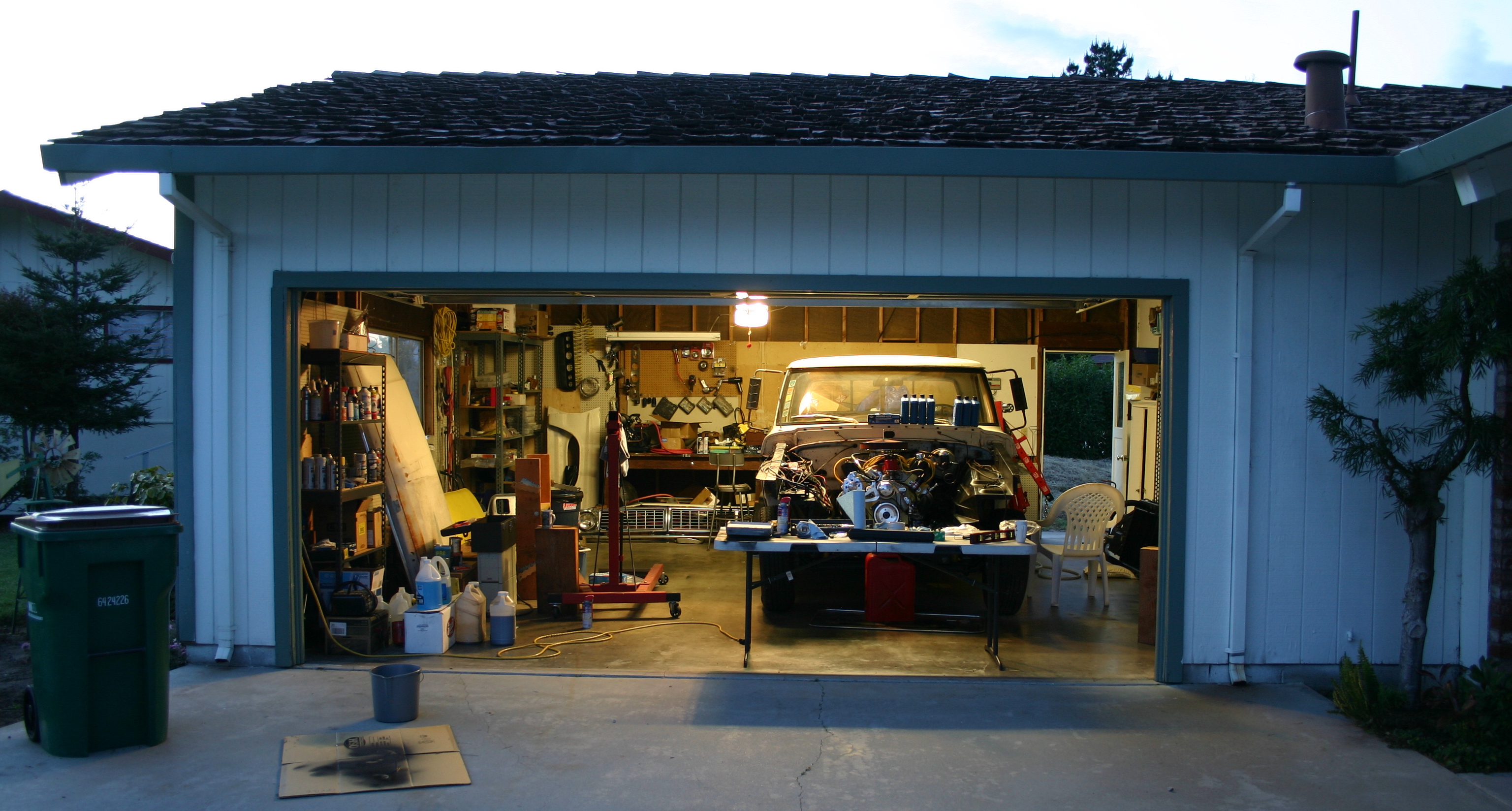

On a related topic, during a rainy weekend I actually started to put together a photo album site, but I didn't get very far with it. I only filled in parts of the "Draintrain" and "Brakes" sections. Here it is: #50 Photos.

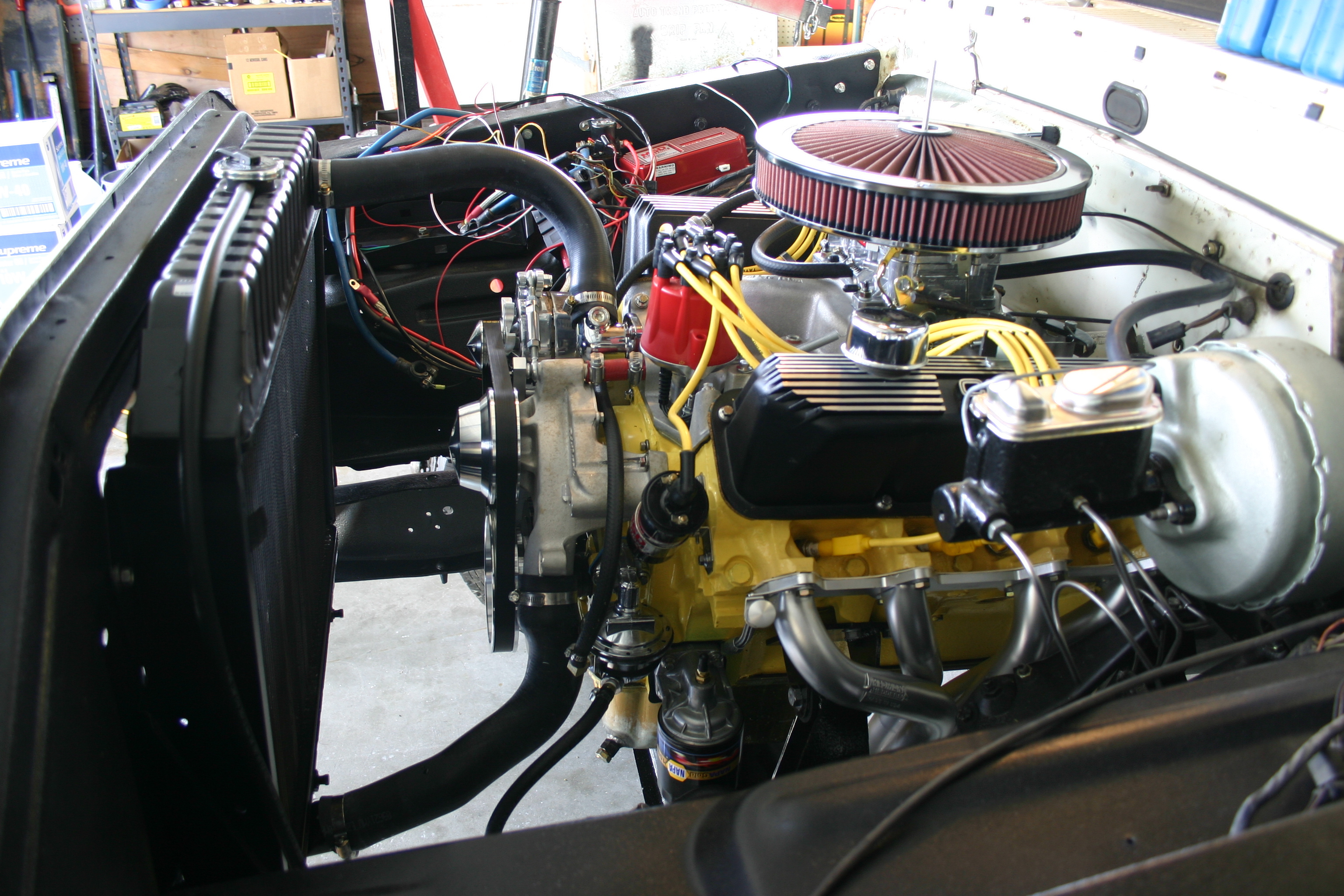

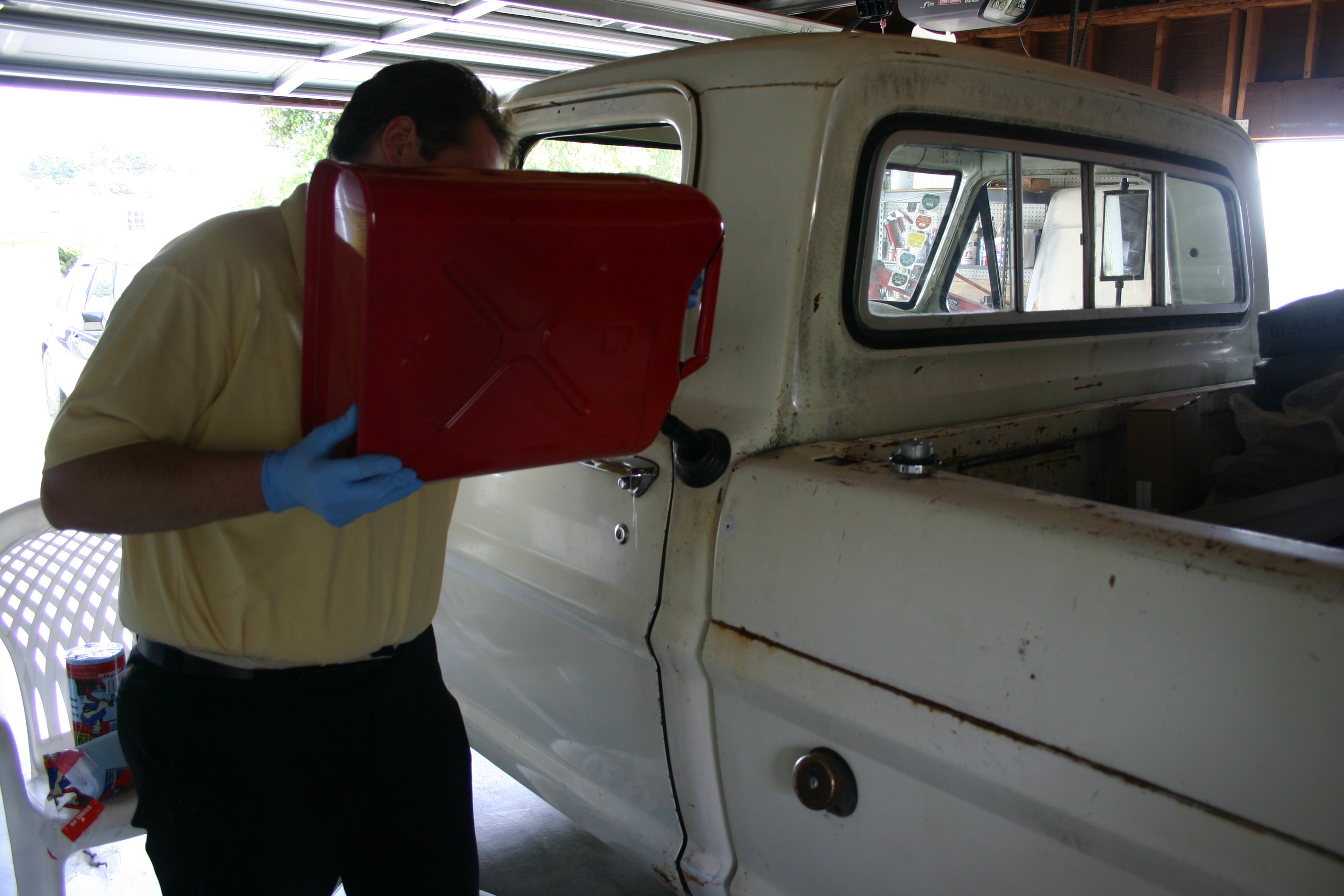

Here I'm loading in five fresh gallons of 91 octane gas. I also got a nicer photo of the engine compartment in natural lighting.
All that's remaining to do is to fill it with coolant, hook up all the wires, and install the battery!

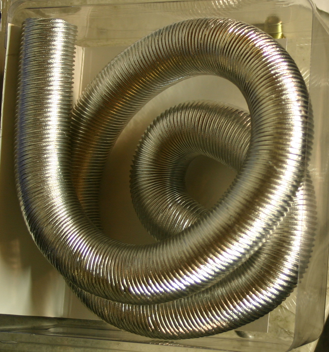

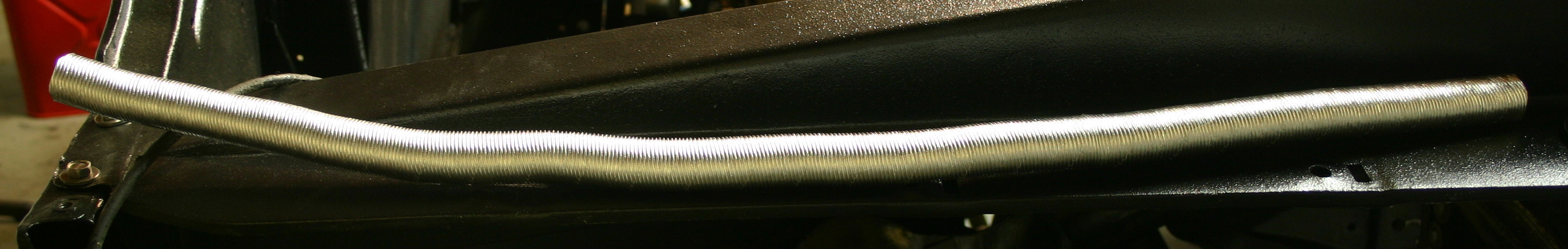

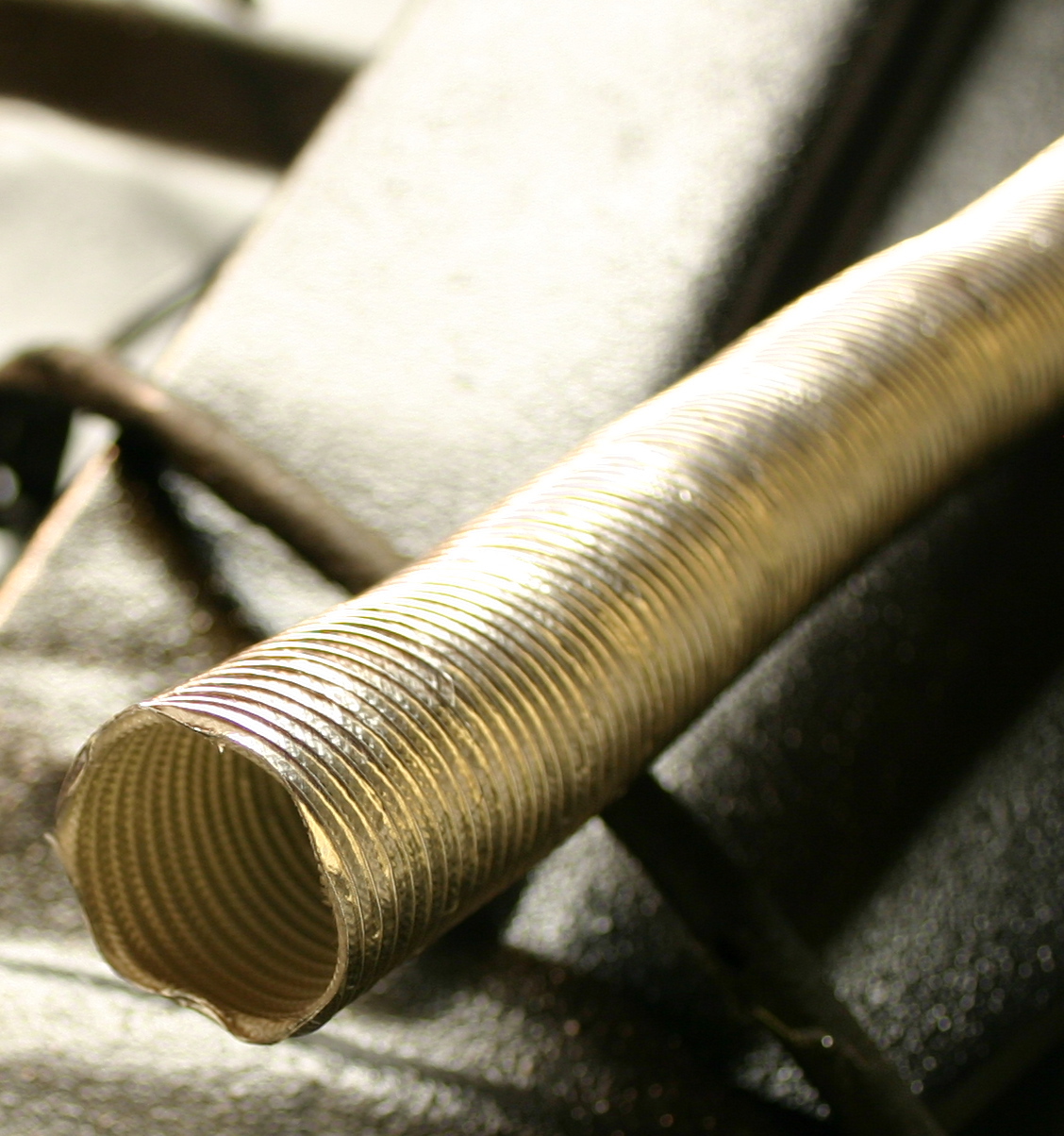

The two wires going from the inner-fender-mounted starter solenoid to the RobbMc starter get uncomfortably close to the header tubes, so I bought this heat shield tubing to protect them. I'll be sure to post better photos of this when I put it together. These photos can be clicked upon to see much larger editions, in case anybody wants to read the box.
Here it is all stretched out.

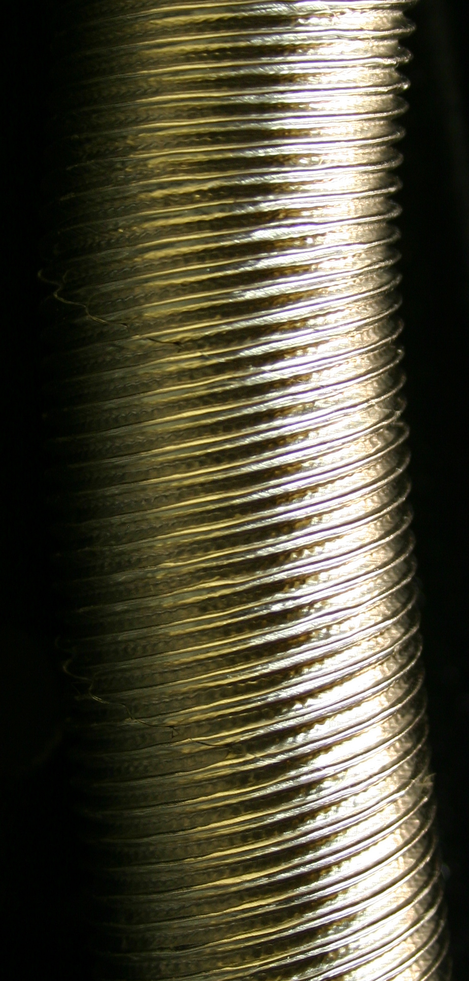

And here's an extreme close-up of the shield's peculiar material: IMG_7259x.JPG
What do y'all think of this type of shield--is it a decent way to protect the wires that run to the starter from header tube heat?

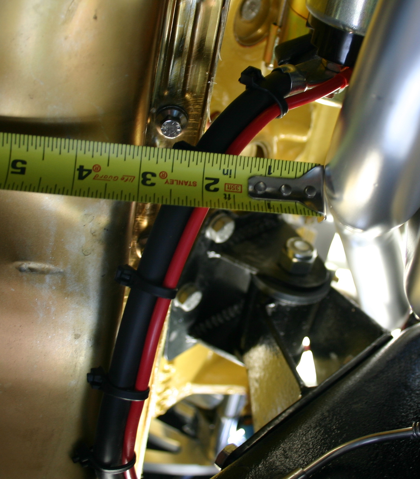

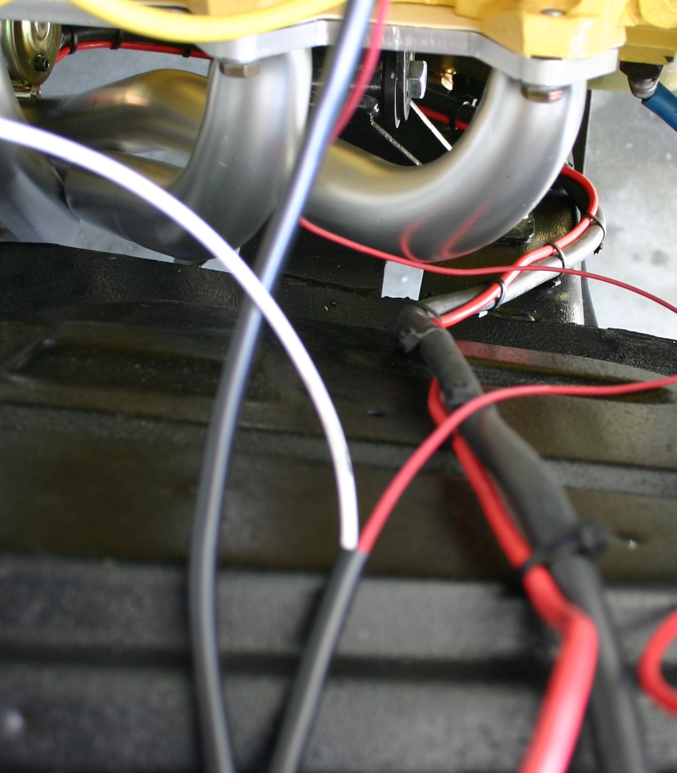

For the starter wires, I run them forward from the starter to the engine mount, then to the frame and up to the solenoid. Larger gauge mains vs. stock too. Note that after cranking for 30 seconds or so if any connection is warm to the touch it has resistance and should be repaired. Dialectric grease works great.

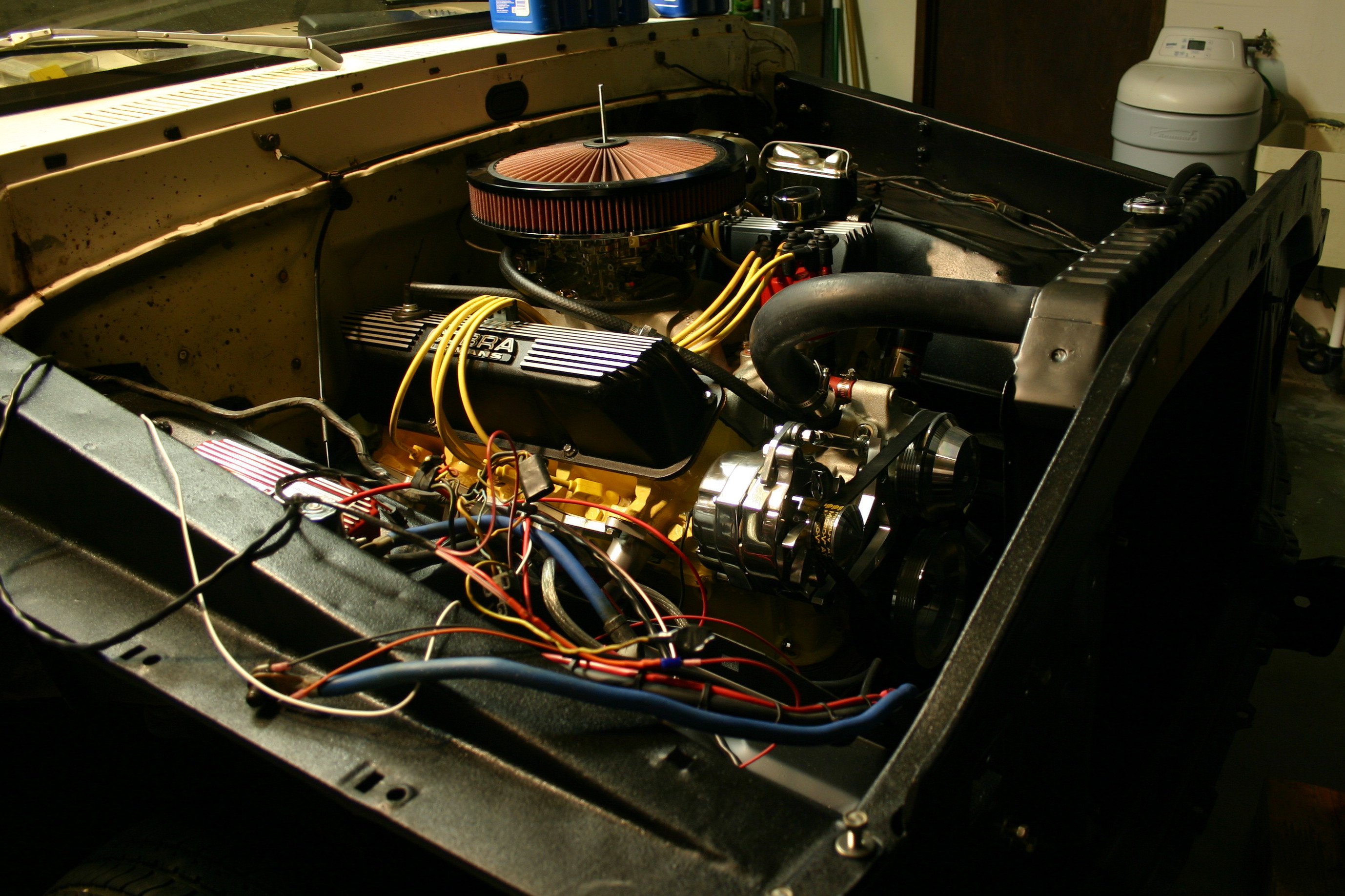

The weather here today has been absolutely perfect, and I made some good progress! Here's a large photo of the California Sunshine: IMG_7298x.JPG

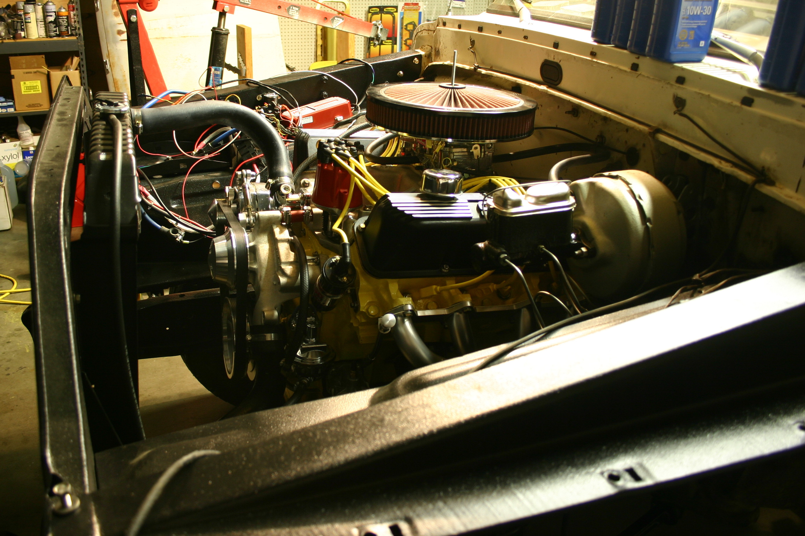

Here's how I'm routing the starter wires--you can see how they come pretty close to the header tube as they pass by the front of the engine.
Yet this is what I'm really concerned about; they pass within an inch or so of the header tube as they get close to the starter. They'd actually get much closer to the tube if not for the torque on the little nuts holding the connectors on at that angle!
So does that heat shield tubing look like a good idea for this area? It's actually long enough to protect both questionable zones (right at the starter, and the area where the wires pass by the front of the header).

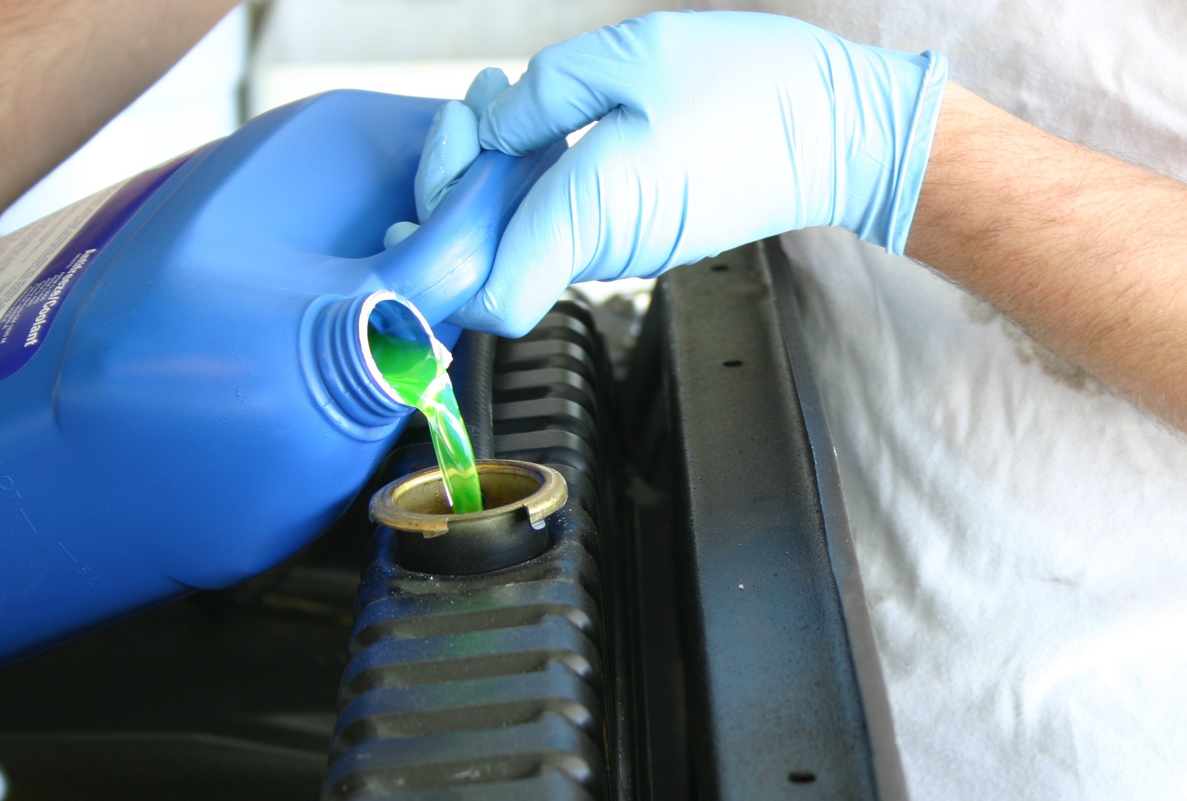

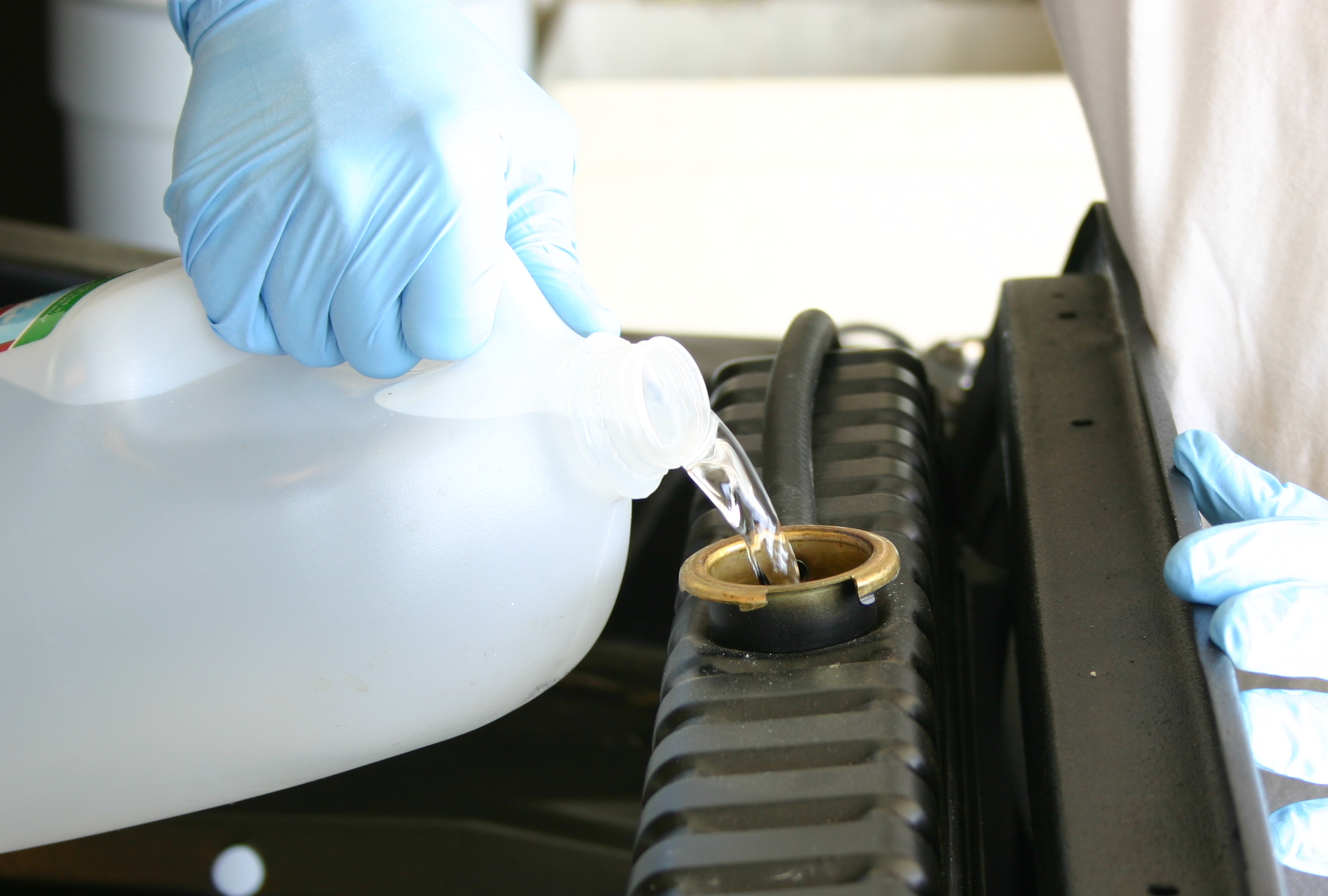

I filled it up with coolant! I put in three gallons of antifreeze first, then filled the rest with distilled water. It took about 4.5 gallons total, although I think the radiator still had some in there left over from before.

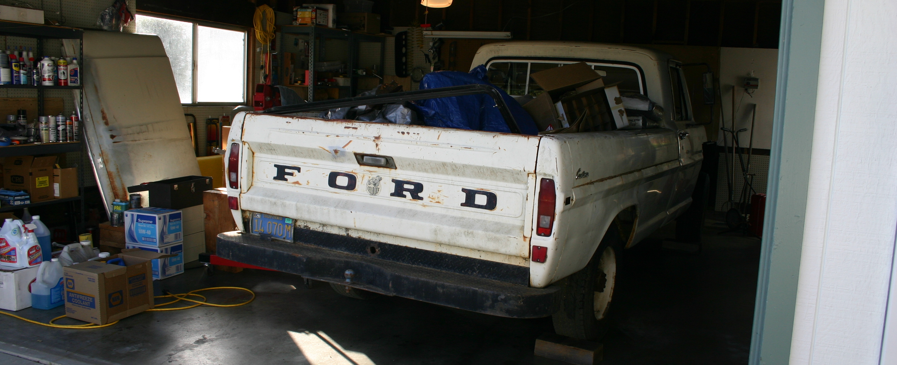

I then spent some time triple-checking the connections and my sanity. Here's how the truck looked early this afternoon:

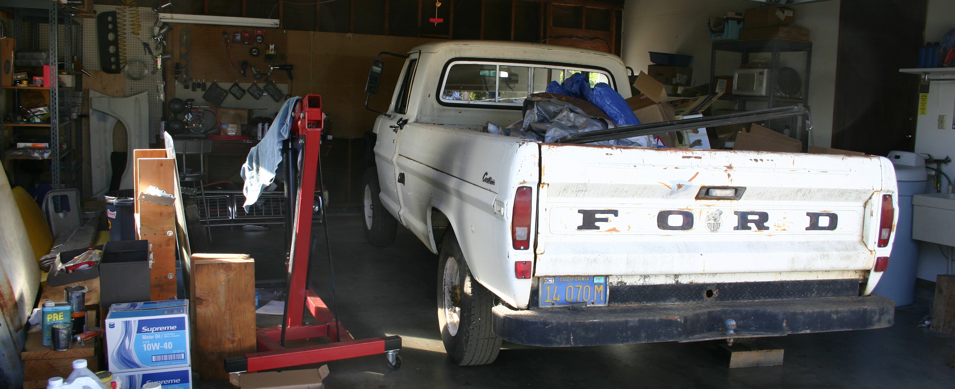

And here's how it looked an hour ago:
Can anybody spot what changed between 2PM and 6PM? Stand by for the full story!

Okay, thanks for explaining that. So your wires run up in front of the engine perch, not behind it, right? I'm pretty sure that's how I have mine routed also!Ranchero50 wrote:For the starter wires, I run them forward from the starter to the engine mount, then to the frame and up to the solenoid. Larger gauge mains vs. stock too.
Thanks for this great tip! I'll take note of the connector and wire temperatures.Ranchero50 wrote:Note that after cranking for 30 seconds or so if any connection is warm to the touch it has resistance and should be repaired.
Great! I have a tube of that on hand, so I'll be sure to use it!Ranchero50 wrote:Dialectric grease works great.

SOoo exciteddd
It must be 100 times nicer working with fresh air and a driveway worth of space now! Not to mention the light and everything else as well.

You turned it around ?
Under its own power?

If it's moving under it's own power, I would almost bet he drove it around the block. I know I would have...
