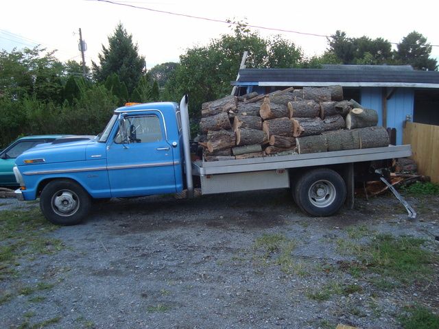

Free wood... Rotted Cherry, green Tulip Poplar and green Cherry on the ground that didn't fit on my truck. Good couple hours. Tarped and strapped it for the ride home. Truck was a little lazy with the weight but cruised along fine.
Now I have to process and store it before Matthew shows up.

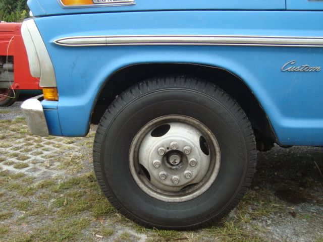

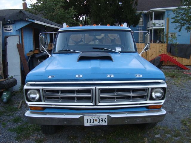

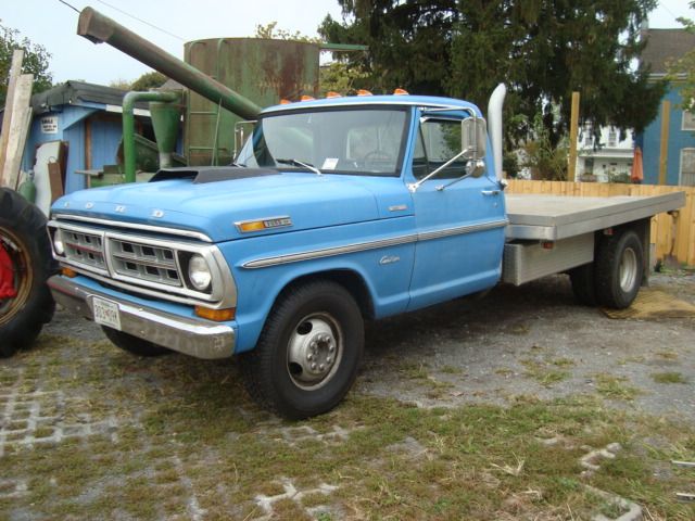

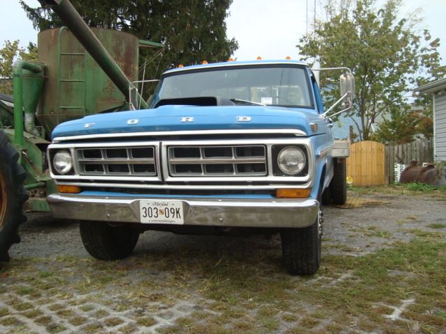

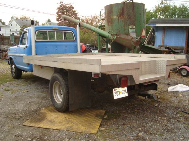

Just some updated pics showing the trucks new front sneakers. Same height as the back but much wider up front. Green thing is a John Deere feed grinder I spent of ton of time rat proofing and fixing some worn out mechanicals on.
Truck is running great. I bought a head gasket kit for it, working on affording studs now. $307 for the gasket kit from Cummins and $400+ for the ARP stud kit hurts. Coolant system became pressurized a couple weeks ago so I think I lifted the head at least once. Nothing blew but the hoses shouldn't be stiff when it's cold.
Truck's currently got a load of plaster and lath boards waiting to go to the dump in the morning.

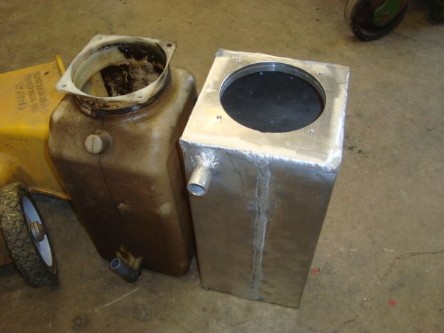

So, today was a truck day, yippee. My hydraulic tank has been slowly leaking from some cracks int he plastic housing and finally forced the issue of me doing something about it. Spent some time making a new flange on the mill and am going to bend up some aluminum for a tank in the morning. Should have some pics then too.

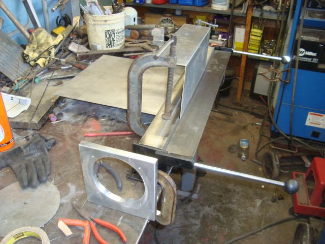

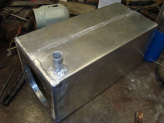

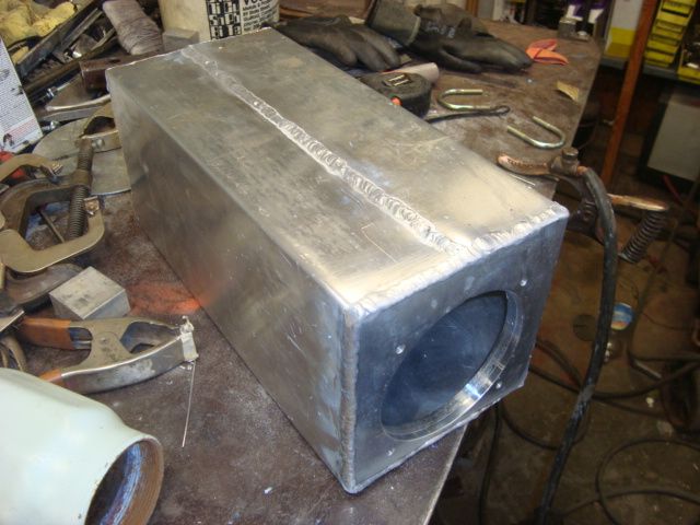

So, machined a flange for the tank, then started making a small metal bender before grabbing a 20% off coupon and getting one from Harbor Freight. Other than needing to clamp the top plate to the bender it worked out really well on the 16 gauge aluminum.
Used the Tig on the sheet metal and had to Mig the heavy stuff. I'm only feeding my Synchrowave 350 with a 30A breaker instead of the 150 amp on it needs.
An old bicycle seat post turned into a new fill / vent spout.
Almost twins...

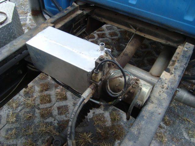

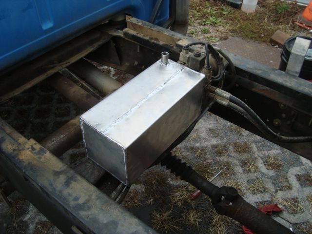

And installed. Of course as I was tightening the one bolt that bolds the pump to the frame, is stripped out. Someone had pushed a standard bolt into the metric hole. I hate that and ended up using a bungie cord until I can get it into the garage to weld up some tabs for the tank.

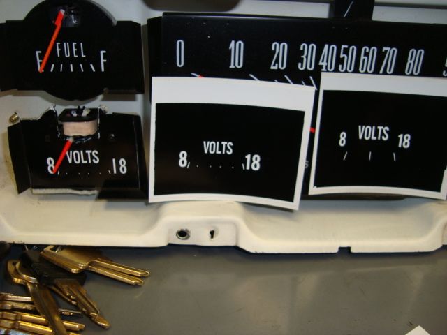

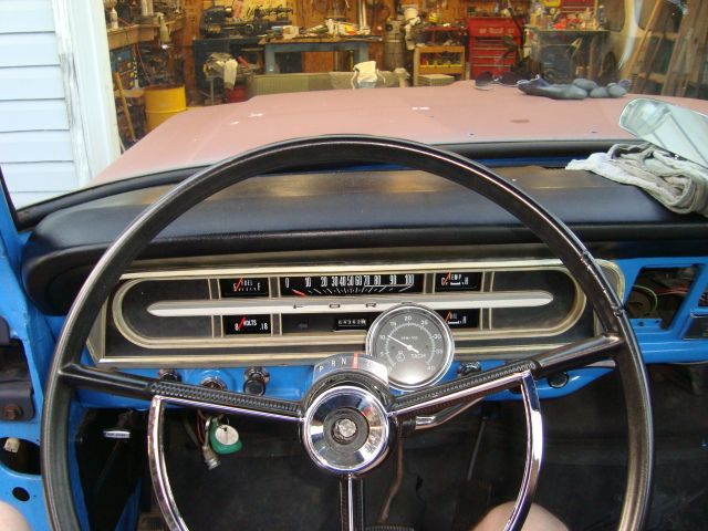

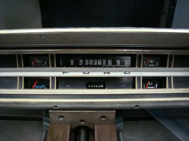

Somewhere along the project I forgot to post up a pic of the finished volt meter, here it is. I used a label print program at work to make the scale.
It's one of those little projects that make the whole driving experience so much better.

That voltmeter is sweet! Looks original too!

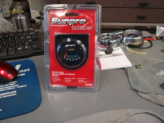

I had a whole thread on the volt meter install but lost it so here's the abridged version.

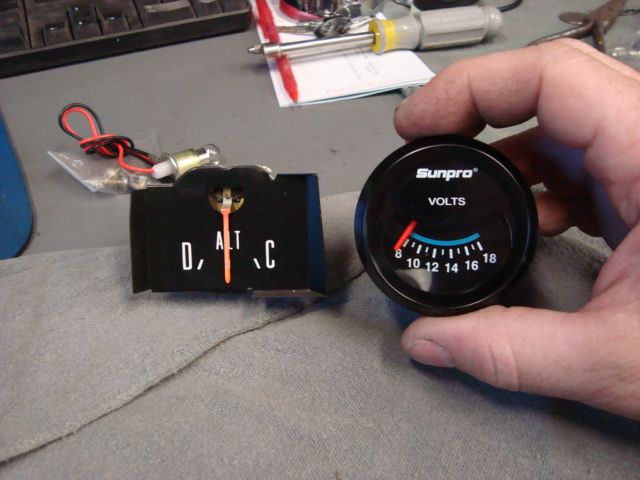

Found one of these at Carlisle for a couple bucks.

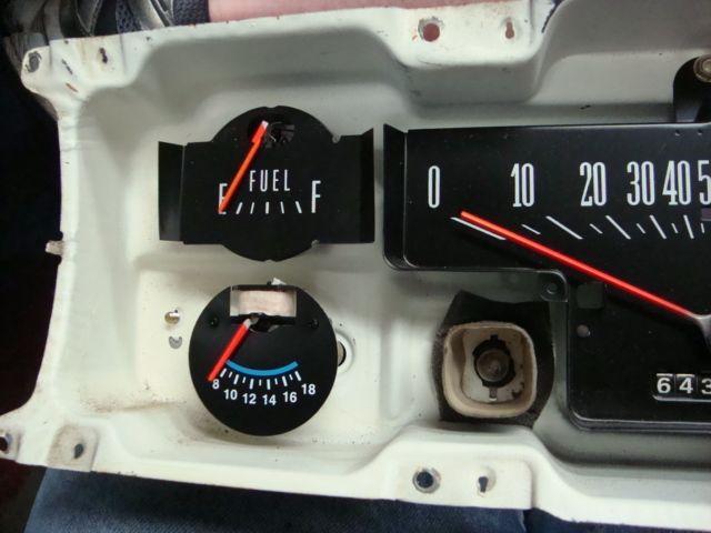

Comparison to the stock ammeter.

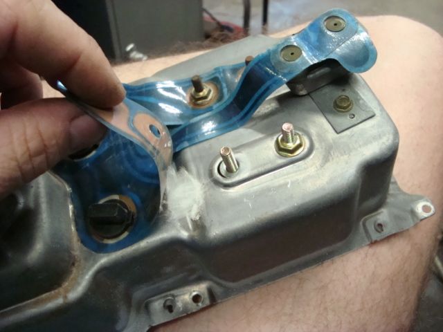

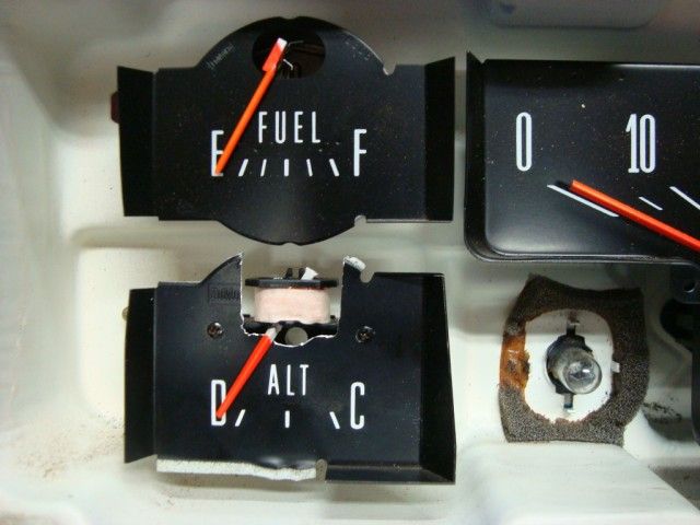

Popped the bezel off with a small screwdriver to take the gauge apart. Ammeter behind it for comparison.

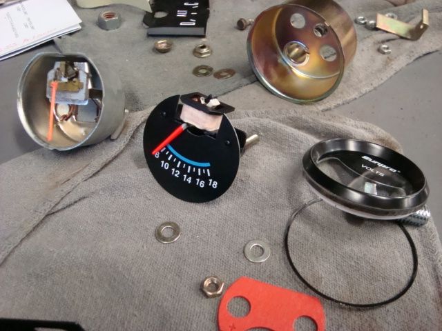

Yep, gonna work but the gauge face doesn't look right or fit

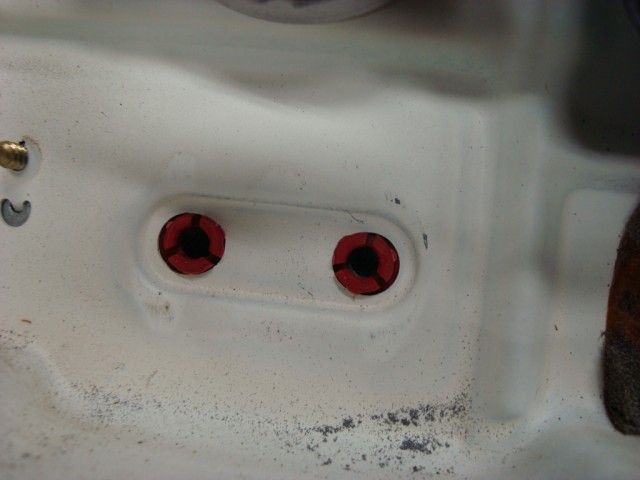

Back side shows that I'll need to open up the mounting holes and use the fiber washers for electrical isolation.
Used a file to fit the stock back plate to the Sunpro gauge
Fiber washers installed. I think I opened the holes with a unibit.
Some decals I made up at work while trying to get a decent font match.
Done.
For the wiring I just rewired the main cluster connector for +vdc and ground.
